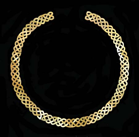

First is the rosette on a cedar top. I want it set in black, so I think the epoxy would be better there.

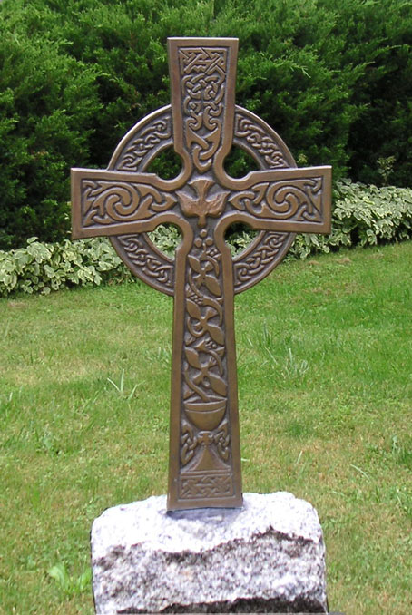

Next is a Gold MOP cross on the head stock, I'll wait to get it, I think that one would be fine with CA and dust for "gaps". It will have some engraving in it, so I posted the other thread for that. Here is what I think the cross will look like.

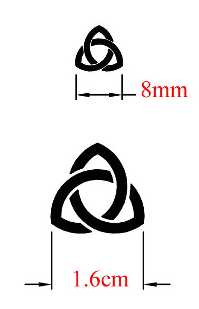

The next are the "trinity" fret markers. I think I will cut out the entire outline and remove all the inside material, than fill with epoxy again, maybe not though.

Rod, on the 1st one I see why you would want to use dyed epoxy -- the shiny appearance of the dyed epoxy filler will look really nice on a rosette.
The second (assuming its not to scale ) I agree.
The third - trinity fret markers -- I dunno as the larger one (1.6 cm) is pretty big and that's a lot of ebony dust to CA in. Are you getting these from Andy DePaule? If so, you might want to ask what he would suggest.Anthony Z38902.1072916667
